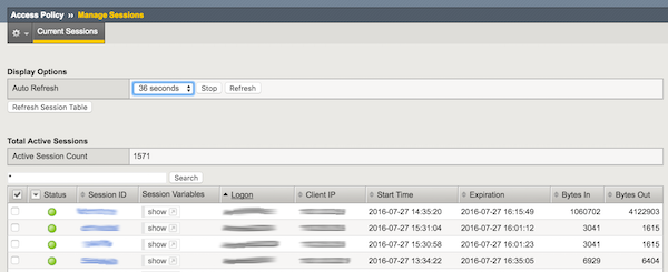

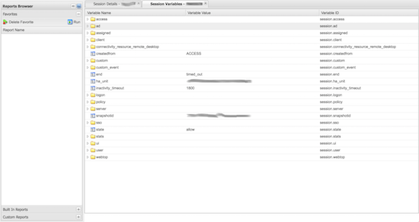

  • Adds a link on the Manage Sessions page for each session that will display the APM logs and Session Variables reports in a new window

  • If you're on a slow connection, clicking the show button to open the session variables may not bring up the tab. If this happens, either try again, or refresh the page after it opens and that should help. This is due to the way I had to get the session variable to open.
