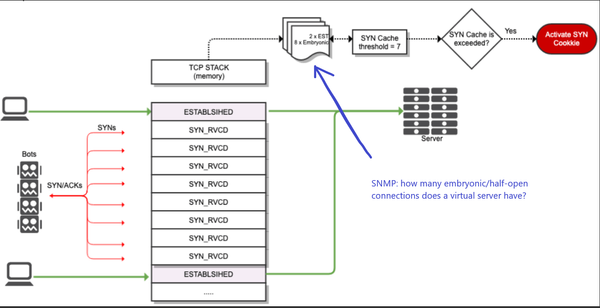

Querying SNMP data for half-open connections on a virtual server
Hello,
I’m trying to monitor the embryonic/half-open connections for a particular VS on my F5 load balancer using SNMP.
I’ve read several articles, including ‘K00560557: Using SNMP information related to SynCookie Protection for monitoring potential Syn Flood attack or Unexpected Traffic spikes’ and ‘K25162232: How to get the Virtual Server state using SNMP polling.’ but I did not find how to do it.
Could you please guide me on how to retrieve this information?
Regards,

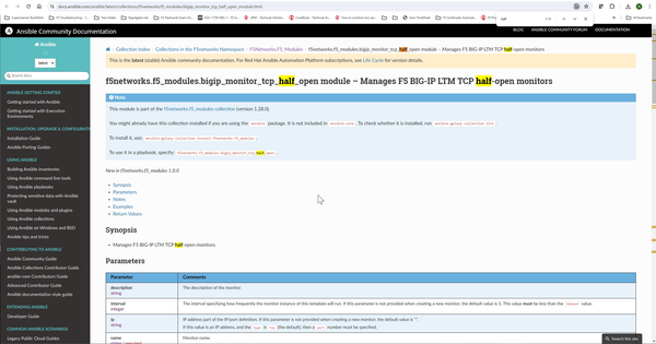

    I dont think there are SNMP MIBs for monitoring half open connections, but you can check in Pools there is a TCP Half Open monitor that can be applied.
    The f5networks.f5_modules.bigip_monitor_tcp_half_open module can be used to manage F5 BIG-IP LTM TCP half-open monitors. This module is part of the f5networks.f5_modules collection version 1.27.1 and requires BIG-IP software version 12 or higher. Some parameters of the module include:
    • description: A string describing the monitor
    • interval: An integer that specifies how often the monitor instance will run
    • ip: An IP address that is part of the IP/port definition
    • name: The monitor name
    https://docs.ansible.com/ansible/latest/collections/f5networks/f5_modules/bigip_monitor_tcp_half_open_module.html

      I appreciate the suggestion to use the TCP Half Open monitor. I understand that this monitor would help in monitoring the connections between the virtual server and the pool nodes. However, my main interest is in monitoring the connections between the clients and the virtual server. A SYN flood attack would cause issues on the load balancer itself, not on the backend nodes.
