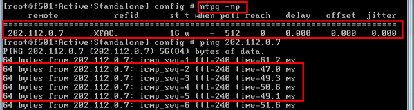

    • yuanqiang_22112's avatar
      yuanqiang_22112
      Ajay ,I found the ntp server not work ,I add more NTP SERVER to the list ,but time still wrong ! F5 can reach to these NTP servers ,how can troubleshooting ?

      Your output shows a stratum of 16 (st). This indicates that your box can't sync with the specified ntp server. Try restarting the ntp daemon. show /sys service ntpd restart /sys service ntpd
      yuanqiang_22112
      @niels vlan sluis ,I have accorded to what you said to operate,the result is the same still . I do the experiment in the VE platform.
