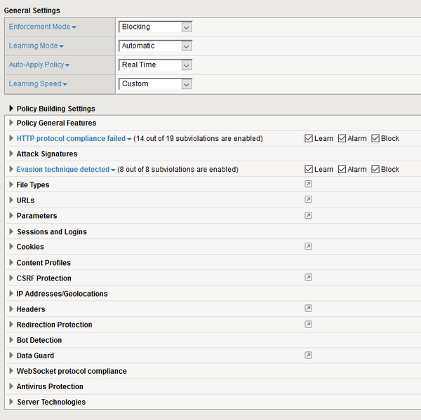

  • Kevin, just for my information, I have the same problem on another Virtual Server, so the idea was to do exactly the same, but there is an Application Security Policy on this VS.
    When I change the setting (same change as for the other), I have this error:
    Is this some kind of a bug ? I do not get what could be the problem with the security policy (it is only a SSL client profile change)
    • Kevin_Stewart's avatar
      Kevin_Stewart
      Could simply be an mcpd validation error. What is the policy doing, and what happens if you try to remove the policy first, change the SSL profile, and then re-add the policy?
    • LIH_admin_22571's avatar
      LIH_admin_22571
      I was about to do exactly that, but I do not really know what this policy is doing, and I am afraid that I will not be able to re-add the policy :)
      May I check something particular in the policy ?
      Kevin_Stewart
      Nothing looks out of the ordinary. So can you replicate this behavior on a "dummy" VIP so that you're not affecting production traffic?
