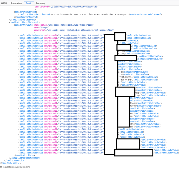

Hi all,
When I use the session.ad.last.attr.memberOf variable the group values are like:
saml2:Attribute Name="groups"
saml2:AttributeValue CN=webaccess,OU=Users,OU=mydomain,DC=com /saml2:AttributeValue
saml2:AttributeValue CN=webtest,OU=Users,OU=mydomain,DC=com /saml2:AttributeValue
saml2:AttributeValue CN=webfort,OU=Users,OU=mydomain,DC=com /saml2:AttributeValue
saml2:AttributeValue CN=webui,OU=Users,OU=mydomain,DC=com /saml2:AttributeValue
/saml2:Attribute"
The question is how can I strip the first group name CN part from each attribute value in a APM access policy using the variable assign element? So in the example above I only need webaccess webtest webfort webui like below.
"saml2:Attribute Name="groups"
saml2:AttributeValue webaccess/saml2:AttributeValue
saml2:AttributeValue webtest /saml2:AttributeValue
saml2:AttributeValue webfort/saml2:AttributeValue
saml2:AttributeValue webui/saml2:AttributeValue
/saml2:Attribute"

    • heenakhanam0708's avatar
      heenakhanam0708
      Dear Injeyan_Kostas​ , it seems the session.ad.last.attr.memberOf is just like how you showed.
      | CN=webaccess,OU=Users,OU=mydomain,DC=com | CN=webtest,OU=Users,OU=mydomain,DC=com | CN=webfort,OU=Users,OU=mydomain,DC=com | CN=webui,OU=Users,OU=mydomain,DC=com |
      and its not presenting anything in the SAML response,
      After using your expression, I am getting like this in the variable output,
      | webaccess | webtest | webfort | webui |
      and in the SAML response, like this
      saml2:AttributeValue webaccess | webaccess | webtest | webfort | webui |  /saml2:AttributeValue
      But the requirement is,
      saml2:AttributeValue webaccess /saml2:AttributeValue
      saml2:AttributeValue webfort  /saml2:AttributeValue
      saml2:AttributeValue webui  /saml2:AttributeValue
      Its a single attribute with multiple values, and it should be presented as multiple values in plain text
