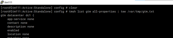

  • you can dump gtm config to text file, open the dump file using text viewer  then search for the vip address:
    "tmsh list gtm all-properties | tee /var/tmp/gtm.txt"
