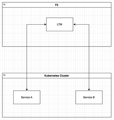

Hi All,
We have vertical kubernetes cluster and put F5 (GTM/LTM) in front of the cluster. Service to service call will be go to GTM/LTM before go to micro service (workload/pod):
service A -> GTM/LTM -> service B
We have problem that the call from service A cannot reach service B (Failed to connect). How to debug/log from GTM/LTM side ( the network team cannot see the data package because it's encrypted )?
If anyone can give advice will be appreciated.
Thanks!

      kismiss In addition to what PSFletchTheTek has asked. Can you verify that the communication between service A and service B has to pass through the GTM/LTM in order to communicate between those two services? If the F5 is not in path between those two services you will have to configure SNAT on the virtual server in question from service A to service B because that could be what is causing the issue. When configuring SNAT I recommend using a snatpool that uses the IP of the virtual server that service A is attempting to connect to rather than AutoMap.

        kismissIn addition to Paulius verification request, and if I understand correctly you will need to configure the virtual server on the LTM module to make the destination NAT to allow service A to reach service B,
        and if you can share the topology design that will be useful in understanding the issue, as I think you use the F5 LTM/GTM modules to work as link controller functions
