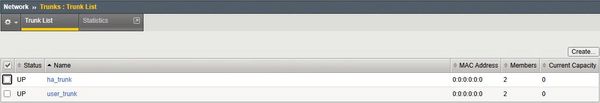

  • Within the trunk details the correct physical interfaces from F5OS will be displayed:

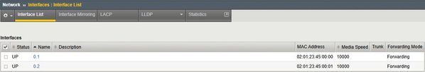

    But on the Interface list they are missing:
    That's why also the error message makes (theoretically) sense:
    ERROR: Unable to find interface object for configured trunk member 3.0
    So what's going wrong internal here???

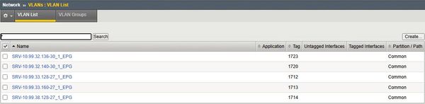

    Now within the tenants we see the VLANs and also the trunks. But the VLANs do NOT show any reference in the "Tagged Interface" column:
    And also for the trunks the "Capacity" column shows 0:
