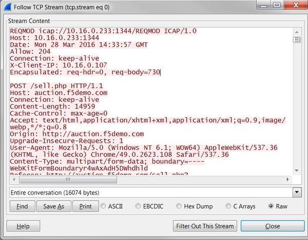

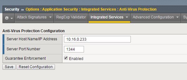

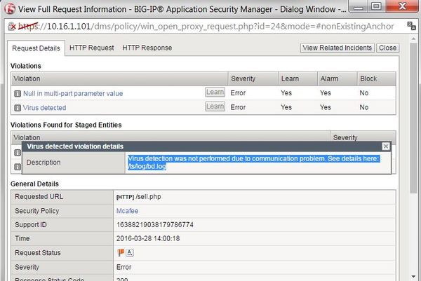

Working on a integration with F5 ASM with Mcafee Virusscan for storage (ICAP server) and the server keeps sending me HTTP response code 400 Bad Request. Below the configuration and Wireshark output and logs.

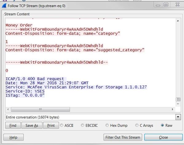

Following is the response code 400

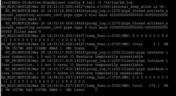

In ASM request log the following is being logged
This is the ouput of that log

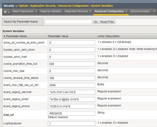

F5 is configured with /REQMOD as stated in the documentation

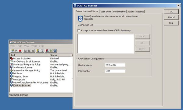

I believe we are using the right solution for ICAP scanning Mcafee Virusscan for storage with ICAP AV scanner enabled version 8.8 hotfix 4 and Enterprise for storage 1.1

F5 has opened a feature request for the integration of F5 ASM with McAfee Virusscan 8.8, currently not supported at this moment. The proper request is /reqmod and not /avscan. - Philipp_Stadler

- Pascal_Tolenaa1
I think you should use the service URI avscan instead of reqmod...

X-Infection-Found,X-Virus-Name is already configured as the variable as default. Dont see much logs appearing in the Mcafee Virusscan - Marvin

The complete reply of the ICAP server is ICAP/1.0 400 Bad request Date: Tue 29 Mar 2016 16:56:06 GMT Service: McAfee VirusScan Enterprise for Storage 1.1.0.127 Service-ID: VSES ISTag: "5800.7501.8114.0" - Marvin
Cirrocumulus
I uploaded the ICAP traffic see below
