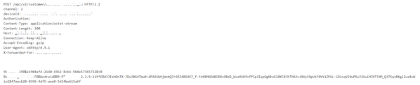

Can iRule mask the payload content on event logs of security
9844445555 password@123
when HTTP_REQUEST { if { [HTTP::uri] equals "/api/v1/client/client-auth/login" && [HTTP::header "Content-Type"] equals "application/octet-stream" } { set payload [TCP::payload] set pattern {(\d+).*?} if {[regexp -indices $pattern $payload match_indices]} { foreach {start_index end_index} $match_indices { set dynamic_length [expr {$end_index - $start_index - 10}] ; set masked_part [string repeat "*" $dynamic_length] set masked_payload [string replace $payload [expr $start_index] [expr $end_index - 1] $masked_part] set payload $masked_payload } TCP::payload replace 0 [string length $payload] $payload } } }

Most of the articles is all about the HTTP_RESPONSES, whereas I need to make the payload changes on the HTTP_REQUEST, and the key challenge is the unstructured format in between the username and password to be identified by the f5.
I will try to work on the application "Content-Type" instead, which seems to more easy because of the complexity on the iRule, mainly for identifying the pattern of the payloads (username and password). Try this article:

Hi F5_Design_Engineer
Thanks for the resources and commands but, I need to mask the the payload on the HTTP_REQUEST so that the Application > Event Logs does not displays the credentials - input the user. try REGSUB -all , something like this to mask you mobile umber or password shown in the HTTP responses
