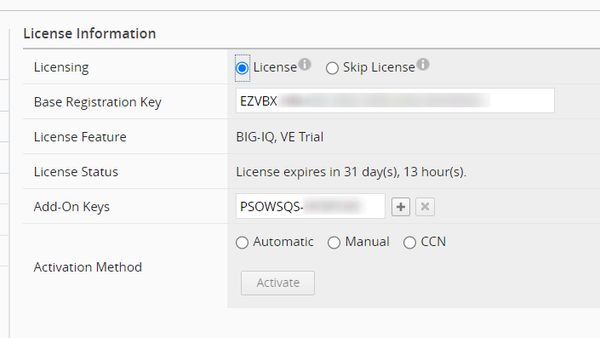

    Went back to have a look at this again today and somehow for the first time looked closely at the Product Name column and then proceeded to  call myself many variations of an idiot. πŸ™„
    Not sure how long it has taken me to spot the blindingly obvious but it has been a while. Up till now I had been applying one of the BIG-IQ Centralised Management (CM) licences as highlighted in the red box. Tried one of the BIG-IQ Virtual Edition (VE) licences and it works exactly as it should with the option I wanted available.

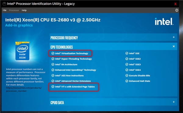

  • Been looking at this some more and wondering if I have found the issue.
    The processors definitely support virtualisation as I have checked it using the 'Intel_Processor_Identification_Utility-Legacy' tool for this and that comes up OK if I have Hyper-V disabled - see below:

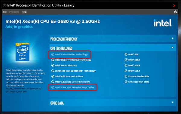

    If I then enable Hyper-V the settings change with both Intel VT and Intel VT-x no longer showing as enabled.
    If I open up Task Manger and look at the CPU details then that does show virtualisation as enabled so it looks as if Hyper-V has taken the role of the Hypervisor and 'disabled' this in BIOS:
    That I think is the issue here - the BIG-IQ setup checks for Intel VT-x, can't see that Hyper-V has taken over virtualisation duties and so I don't get the option to build a BIG-IQ. Looking at the requirements listed in the Hyper-V Set up guide would appear to back up my initial thoughts that this could be the problem:
